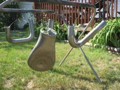

Can't. Have no idea where the tune is, and I need a better ignition box with boost retard. Mopars like timing, and I can't run it too retarded or it'll run hot under normal driving. That, and all my cold side tubing is back off so could paint it. I found a pretty cool color at the paint store that was mixed wrong so I got it real cheap. It's like a pewter with a lot of metallic. Looks cool as hell in the sun. Too bad it's all going under the hood....... Gonna go put that back together right now.

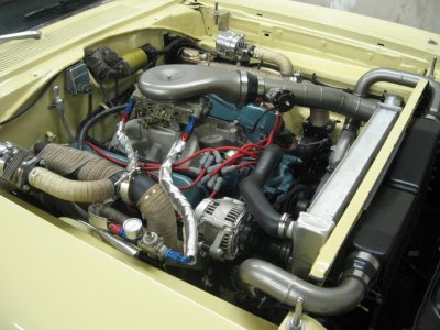

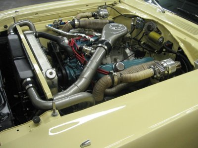

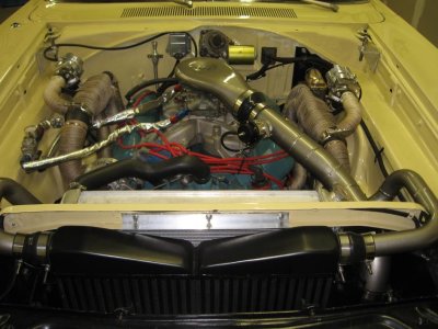

Everything's back together. Just gotta tune it now and change the ignition. Woo-hoo!!!!! Haven't really driven it much, just around the block a couple times.

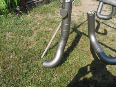

Making some changes. I never liked the waste gate location, so I got some new smaller ones, and I'm adding power steering, which entails me redoing the entire left side of the system. I'm also doing a bunch of suspension upgrades, bigger brakes front and rear, sway bars, fatter torsion bars, but that's gonna wait until after under the hood is done, (or really close, don't want too many irons in the fire)
Here's the pile of parts
I had to move the turbo over a little bit, here's the new downpipe.
