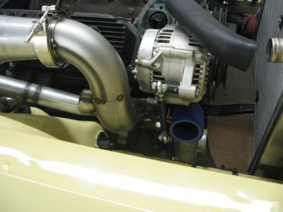

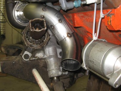

It's finally starting to come together. I've been stalled out for a few days because of defective tubing. Downpipes are done, still gotta figure out where to put the wastegates and where to shimmy the alternator in. I think I have a pretty good idea how I'm gonna mount it. I'm waiting on exhaust flanges (hopefully by the weekend) and then I have to make some adapters on the lathe to make them work. I have a bastard set of turbos that have a 2.5" inch outlet hole, but the flange on the housing is for a 3.5" v-band. Fun fun fun......

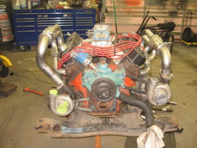

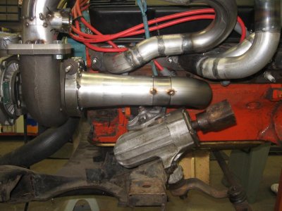

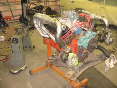

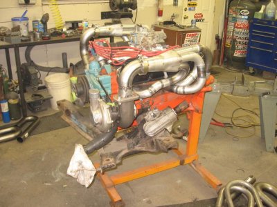

Still pluggin' away. Most of the hot side is done, all the pipes and headers are at my buddies right now so I can TIG weld them. I'm still learning how to do it though, so he usually helps. Hopefully all that will be done by the weekend. He's also making me new turbo support brackets on the CNC that'll look nicer than the mock up ones I made.

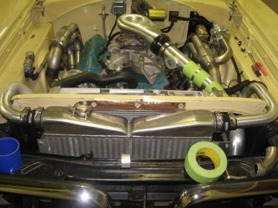

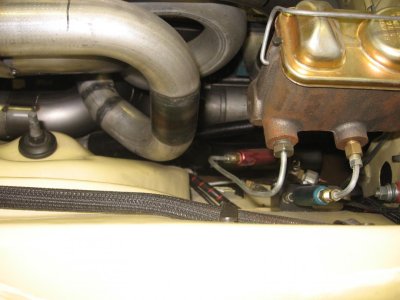

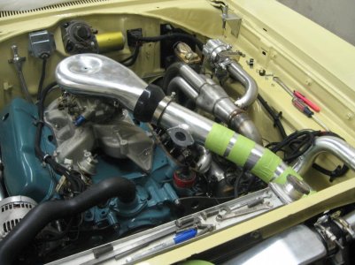

Yeah, same here. It's slowly getting there. Here's a few more pics
