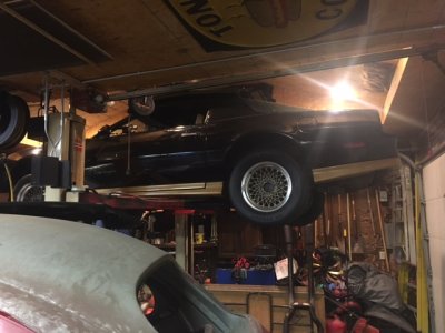

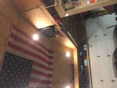

Nice to see some projects making progress. Mine is on hold for a couple months as I needed to finish my garage project. I picked up a hoist last year but the ceiling wasn't high enough to get the car all the way up. Now that I have that project done except for the attic access, I need to get my Firebird ready for spring. Then hopefully I can be back on my long term project. Sorry about the pics. I'm not sure why it keeps rotating certain pics.

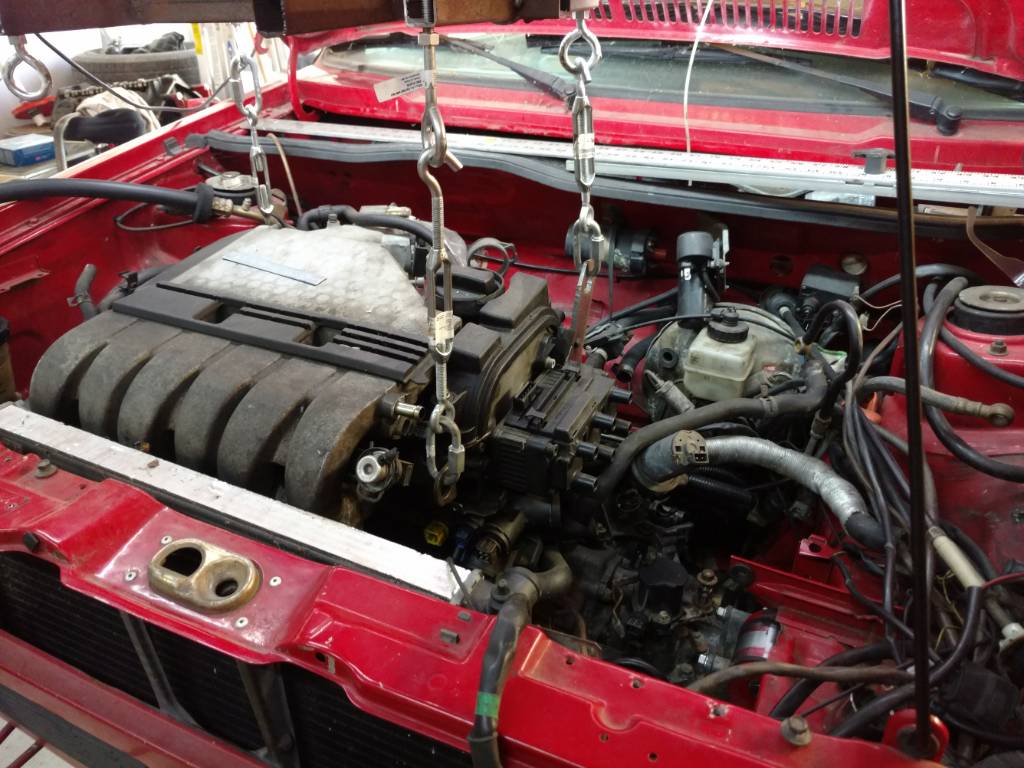

Not on the back burner any more. 86 VW Cabriolet VR6 conversion. Driver's side and passenger side mounts fabbed and tacked... Which is good since I decided to shift the motor 10mm rearward yesterday and lifted the motor 10mm. Up for halfshaft clearance, rearward to get more clearance to the rad. So glad I have resisted the urge to fully weld those mounts. Also started making the torque reaction mount, based on the MKIV mount design. Ordering exhaust tubing tonight to build the exhaust from the manifolds back.
