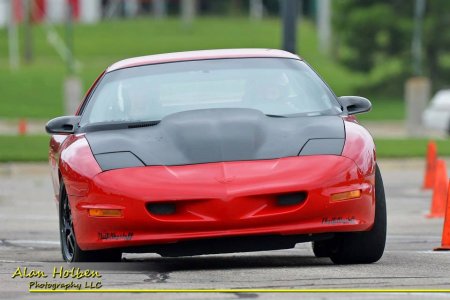

'94 Firebird formula
I looked at that pic again and have to laugh.... You took it On Knowles Rd just North of Addison Rd.
Sounds about right, it was shortly after I left there lol I have to meet him in Jackson sometime this week to grab the harness and computer because they weren't at his shop, but other than that it was an awesome deal. Getting an engine stand this week so I can start cleaning it up.

I had a blast auto-xing my Formulas. Koni shocks/struts and sticky tires made a huge difference and was way more fun.
it is fun indeed, i need more tire though. these are 275 toyo RA1s and i'd really like to get some 17x11s and go with 305 or 315s for at the auto-x.
here's a bunch more pics i found from the last coupe events
