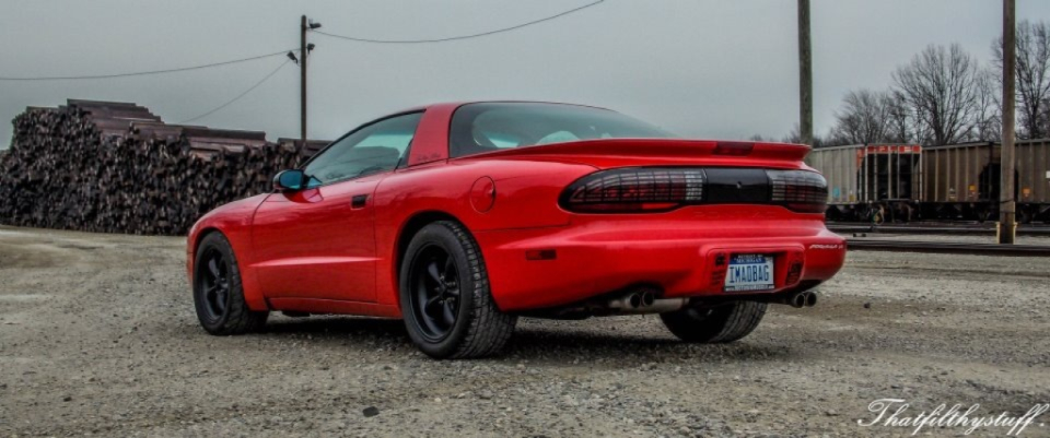

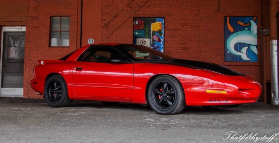

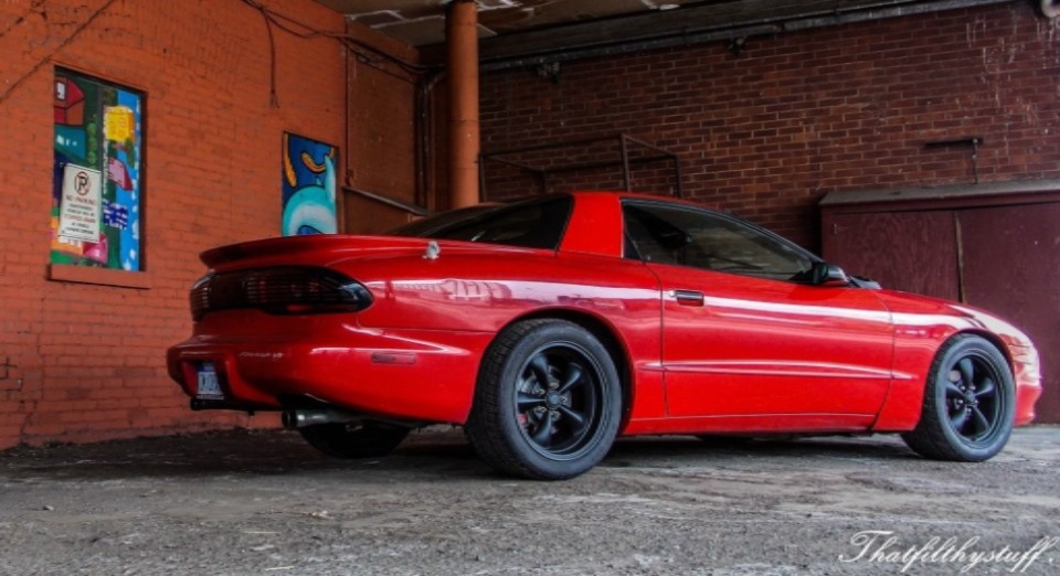

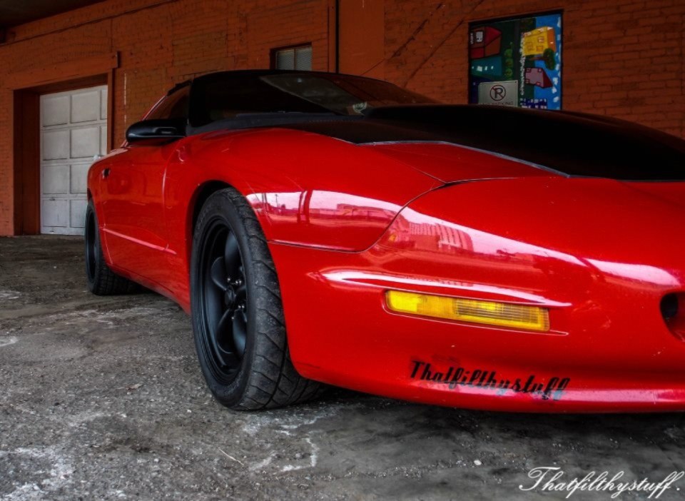

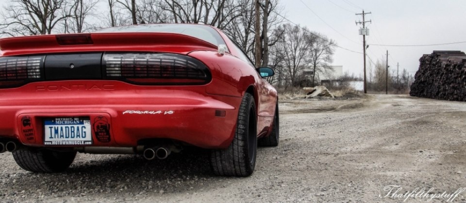

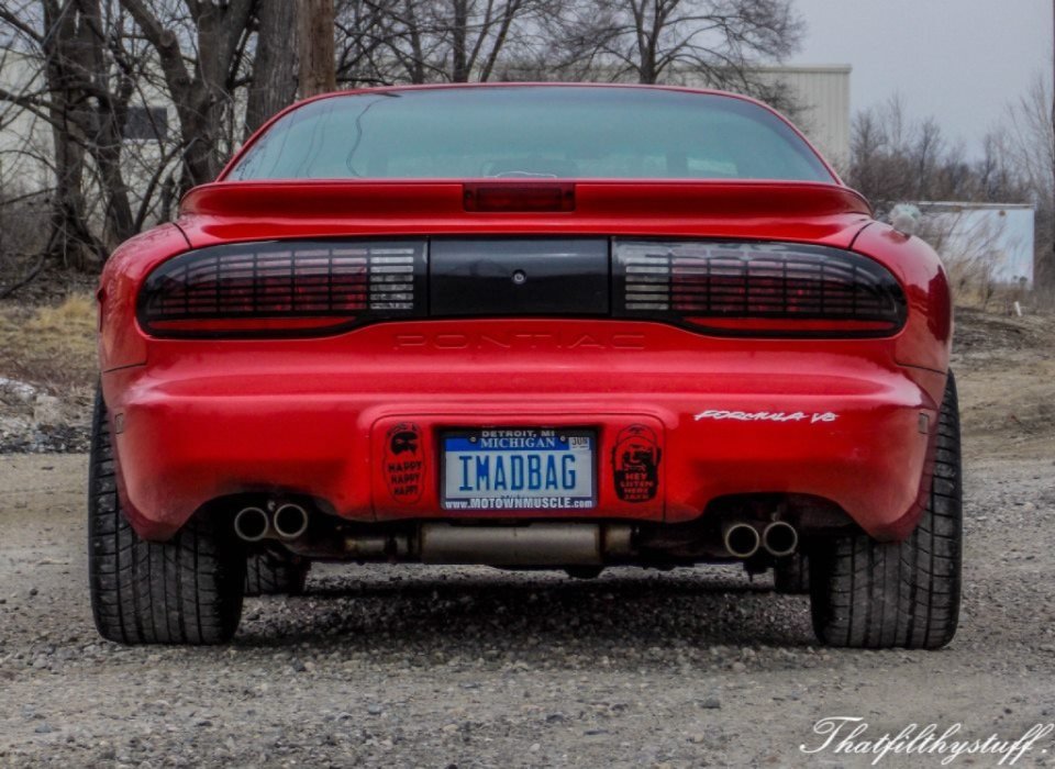

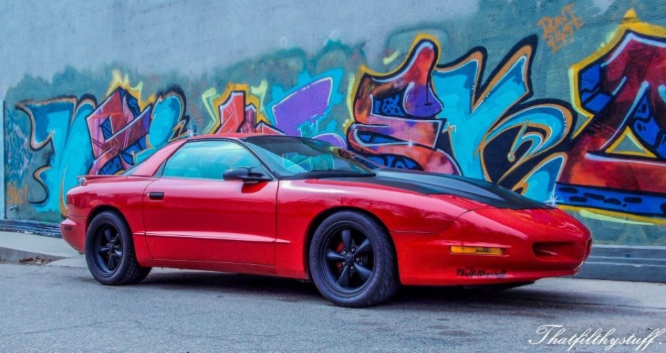

Sold my Torque Thrusts and then bought a set of C5 motorsports wheels. I hate polished lips on wheels so I plastidipped the lips black and left the faces gloss black. They currently have shaved Toyo Proxes RA1s on them so that should make the next couple auto-x a bit more fun.
Sorry for phone pics, better ones at the auto-x next weekend.

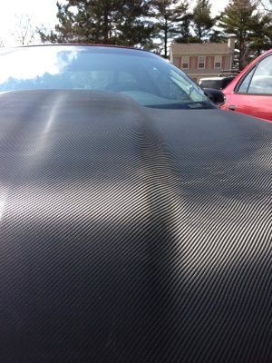

I like the hood!

I like the hood!
thanks!, i'll be PMing you about those engines.
