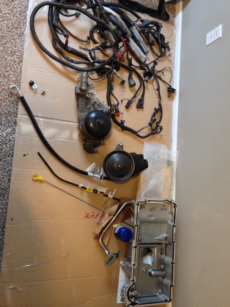

Fricking unreal...
The wife loves lugging boxes in the house all day from the delivery guys lol
Thanks Superman09 for the care package!
Thanks! I'll be having more fun once it's all on the car lol
Thanks Darko for the FAST rails.
Ohh yeah it's getting plastidipped too.

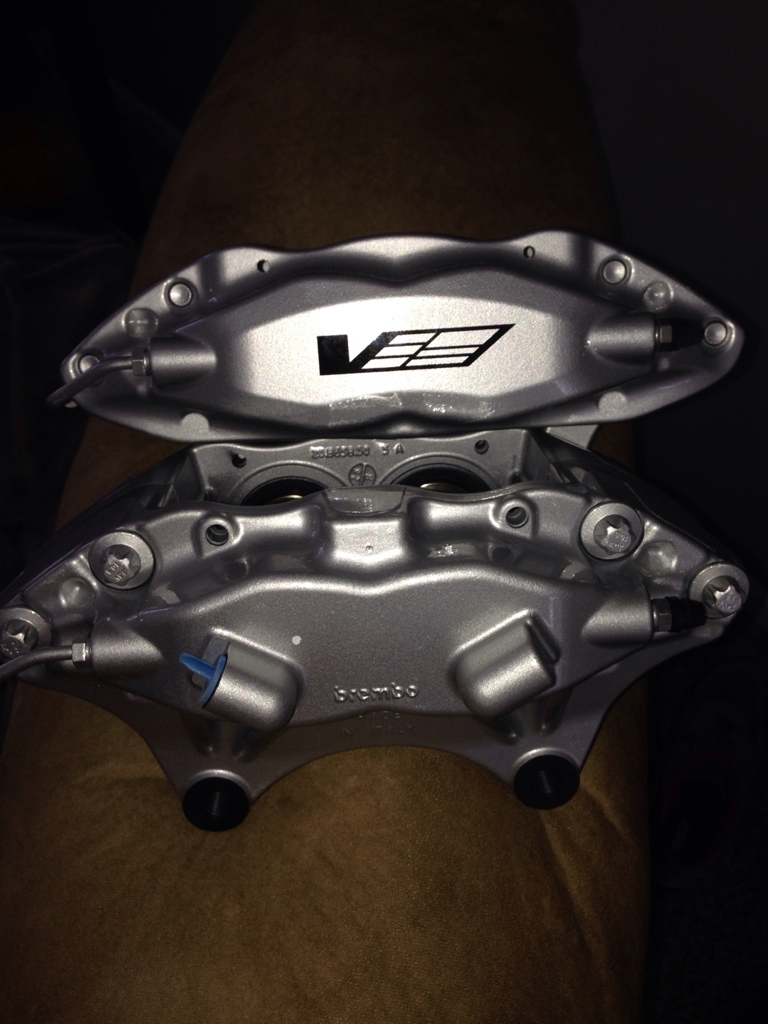

Had to get 18" wheels to run the brembos, I ground down one to fit a 17 and it was pretty sketchy looking. Soooo I traded my ZR1s that I loved for some C6 DD 18s. They need wider tires but it'll do. They were chrome, and that wasn't happening, so plastidip happened. Black with a layer of glossafier.

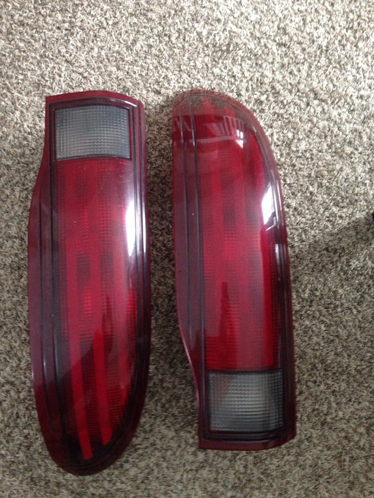

Cool man. I like the chrome but I know that is not the "in" look. Just curious, what is the reason for the V6 style tail lights?
