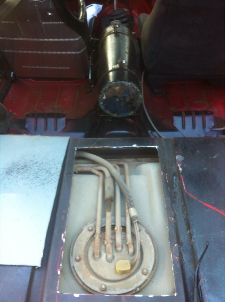

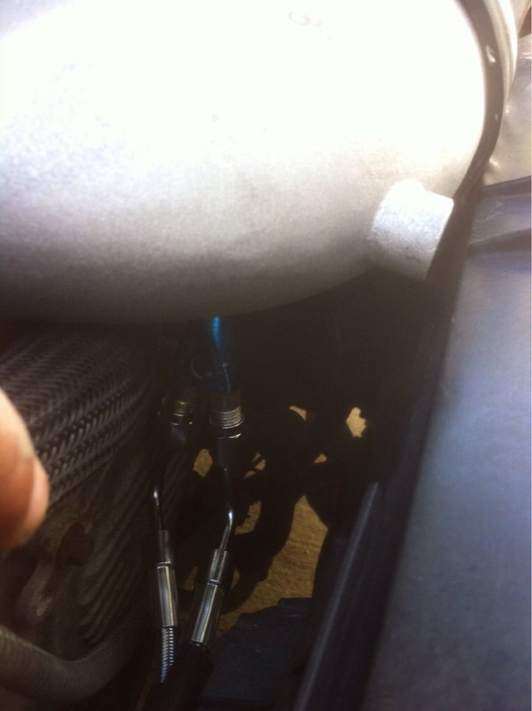

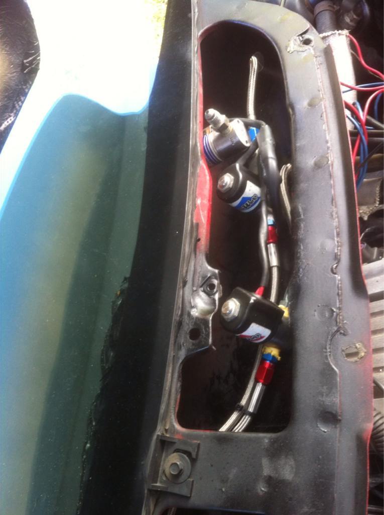

Dropped my car off to my friends business, Antilag Racing, over the weekend to have a wet nitrous kit installed. I couldn't be happier with the way things turned out! It is much cleaner than I expected and without it being pointed out most won't even know it's there. All the solenoids are hidden in the wiper cowl. They also put in a 255 fuel pump for me as we'll and made a badass kevlar cover for the fuel pump trap door. i'll be spraying a 100 shot on my LT and once i swap my 5.3 in probably spray that as well.
It looks like a carbon fiber access panel? But looks like you are going to weld in place???? I don't get it...sorry for my ignorance.
