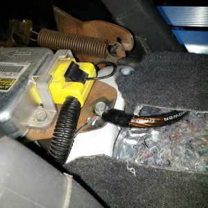

I upgraded to 4 gauge wire and the amp is still getting hot. I thought maybe my ground wasn't any good, so I rerouted the ground here underneath the center console. It is an existing ground location:
amp is still hot.
Is this not a good ground? What other problems could it be? Head unit is a kenwood ddx8901 and i only go as high as 28/35 on the volume.
I am stumped.
amp is still hot.
I am stumped.
This is a class a/b amp they do heat up. You are saying hot. Is it hot to the touch or shutting down/ loosing sound? Where is the amp mounted? What ohm load are you getting with dvom connected to speaker leads at e amp. ( disconnect the leads from the amp to test.) You can also back probe the power input to the amp while its playing note if your dropping voltage.
Low ohm load can drive heat, voltage drop will as well, proper amp ventilation is a requirement. * might be normal if your not having sound issues or smells.

That JL shouldn't be getting hot at a 4 ohm load. Give more details on the speakers you're running and if they have an active crossover inline.
It gets really hot. Doesn't shut down, but it will burn your hand. The amp is on the floor in the backseat.

What do you guys think of that ground?
And the sound is amazing. I have never been so happy with my system.
