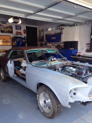

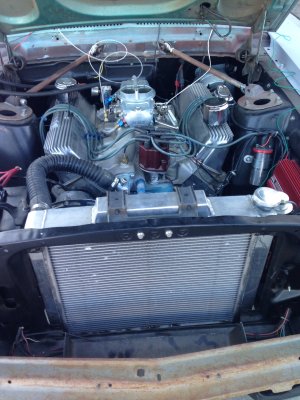

Guy original bought it for his wife, they split he got the car and took the 289 auto out and replaced it with a built 390 that has been broke in but no miles, it's balanced and blue printed, bored .60 over, edlebrock performer RPM heads and intake, comp cams 292H with 560 lift, Demon 850 carb, MSD distributor with 6AL setup, Hooker ceramic long tube headers, Aluminium radiator and Canton Oil pan, says it' should be around 475-500 hp...has a shatter proof bell housing 4speed top loader, with Hurst shifter and centerforce clutch all rebuilt with 0 miles the rear end is a 9" out of a Lincoln Versailles with Wilwood disc, 31 spline axles and Detroit Locker with a 390 gear also fresh with no miles

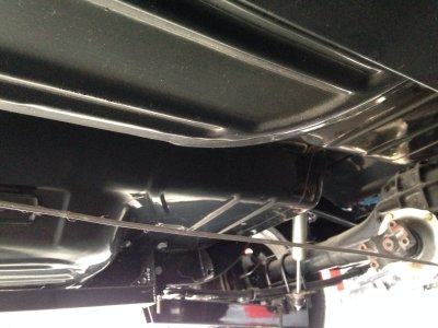

It's originally a California car and spent all of it's 20 years in MI in a garage. The original floors and quarters, front and rear suspension all new.

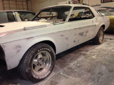

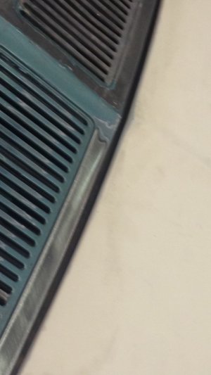

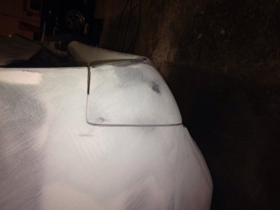

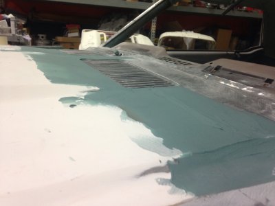

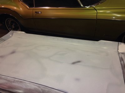

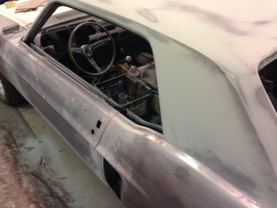

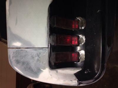

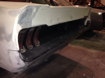

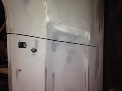

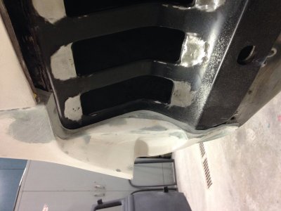

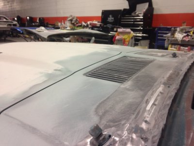

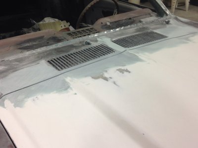

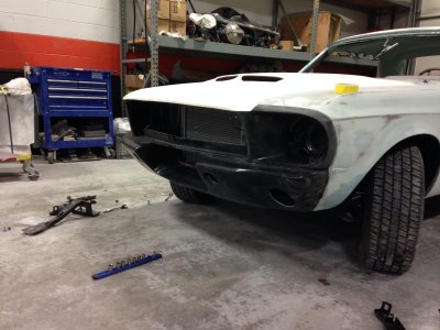

So the plan now is to shave drip rails, cowl vents and flush out tail lights, weld up all the emblem and trim holes and roll all the wheel lips, running 18x8 18x10 kind of a FR500 style wheel with a fat rear lip. Headlight buckets and quarter extensions are getting bonded and smoothed into fenders and quarters. Then comes all the bodywork straightening and sharing up all the body lines.
Car is going like a True blue metallic all the stainless will go satin charcoal or black, may do a satin charcoal super snake style stripe. Interior is gonna be the full TMI R Sport setup with the one piece suede headliner
So the car was built to do down the track and cruise but I'm adding the protouring look to that. Can't wait to get going on this. Still got a little time before I can really start digging into it but I can at least start on all the body mods and getting it ready for paint!
