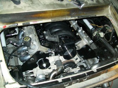

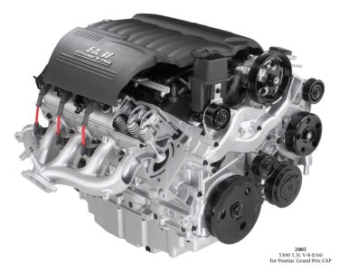

I confirmed the LS4 crank snout is shorter, nothing that can't be done to a regular LS crank though. The single belt is basically where the AC belt is on the pic you show. It migh tbe tight, but it might clear the body. The MR2 PS pum pis not a bad option though, I've seen it used before. I think the Fiero had a electric PS pump too, I assume for the same reasons. FWIW, putting the pump in the back for added capacity only buys you time before it overheats, it will still overheat if there is a thermal issue. I don't know how much open- tracking you plan to do, but IMO, keeping the PS fluid from travelling from the front of the car to the back is one of the benefits of an EPS setup. Adding a steering cooler up front would probably be a simpler, effective solution if the need arises.
