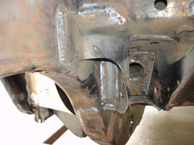

tying those upper boxes in to the cage is a good idea. nice work.
pacecarBBC did twisteds 82 gt like that , we stole the idea and copy'd it ...
its really nice having twisteds car there done , when we are working on mine we can always look at his car and see what need to be done..
looks great guys!!!!! Justin put a plate between the frame rail and the upper torq box, look at your car, it ties the upper right to the frame rail. just my .02

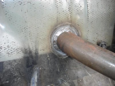

Got bored sitting around today so I finished the driver side torque box. I added the plate that Todd told me to add on the left side of the box, welded in the rollcage tie in, and even welded the tube to the floor on the inside of the car for practice- welding thick tubing to sheetmetal sucks- especially going around a tube :nopity:
