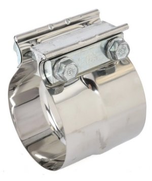

By the way, here is the kind of clamp I always liked - and I pack the shit out of them with copper RTV. You should be able to get one in the exact size you need whether it is smooth or stepped. You can't get them at normal auto parts stores, but I used to get them at the local truck parts store. Summit and Jegs have them too. They are a bitch to get apart once the RTV cures, but they seal pretty good. Just make sure you let them set overnight, because on a boosted system, they will push the RTV out if it is not cured.

Curious where you're putting copper seal on this clamp? Just a bead around the pipe when you clamp it down?
But yeah, get this kind of clamp, or get some pictures of where you have the leak and post them, then we can see what's going on and guide you with better info.
I slather up the joint like crazy first. Until you can barely see the pipes. Put extra around where the bolts sit. Do not slide the clamp on. Just wrap it on and move it as little as possible. Then clamp it. I have had a lot of luck doing that.
