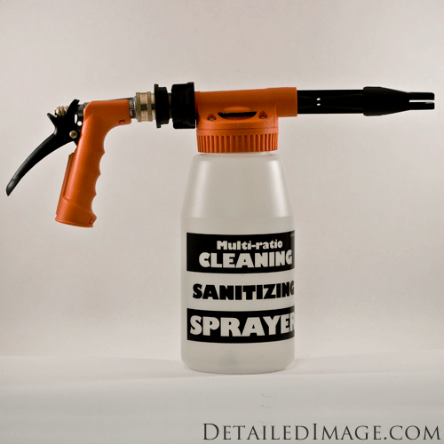

Looking to pickup a foam gun. I was looking at the ones over at Autogeek. Let me know what you think.
Thanks
Marc,
Thanks
If for a garden hose, they work pretty well. Be advised that it's not a foam lance, though. I have the Gilmour Foammaster and it works well.

Yeah, I like it. I use a lot more soap than normal, though. I've found Meguiar's NXT Shampoo foams really well with it. I can only find that at Meijer....not sure why. Again, it's nothing like a foam lance, but works great for a pre-soak to loosen dirt/grime. Also keeps the paint very well lubricated if you wash panel by panel.

Ok, looks like the same one as the one at Autogeek, same price and all.
Yep, these are all generally the same thing. If you have a Karcher pressure washer, Karcher has a foam attachment that goes for $25. It foams much less than the gilmore or the Autogeek one, but for $25 you can't go wrong. We keep one as a backup. but rarely use it. The increased foam from the AutoGeek makes better pictures :)
Perfect review.
+1 to everything he said.
