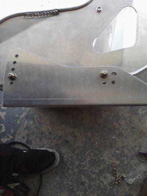

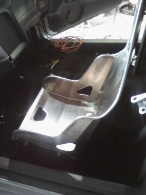

Ok So I started mocking the seat up for install. Alot of this shit I'm just doing I've never done it before so I'm learning as I go!

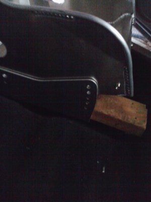

Decided to throw some 2x4's under the seat to see how the height would be after sitting in it it felt like a real good starting point and with the adjustable brackets they have plenty of room to move around. My head wasn't to high and I could see over the gigantic 6" cowl.
Once I got it in position I used a transfer punch that was the same size as the holes and gave myself some spots for my drill points. I put a scale on these and checked a few different points on the seat to make sure I was as even as possible on both sides and all 4 holes.
Here the Bracket is mounted I'll have pics of it in the car on Saturday and Probably start mocking up the steering wheel as well.

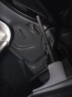

Ok So I actually got a decent amount done today.

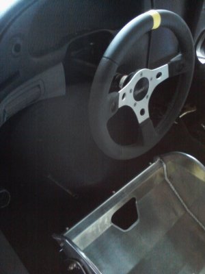

Seat got mounted!I did end up lowering it to the lower hole on the bracket. After sitting in it for a good 20 minutes making sure I could reach where my switches will be and pretending to shift.... I didn't really do that.... I took a picture.

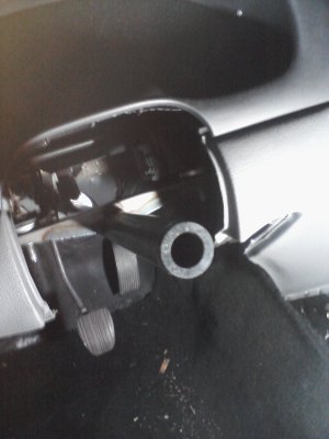

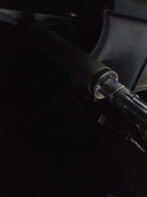

I had to cut the Tube for the Column to the length i wanted I ended up cutting off about 4 inches. And pressed the Vinyl bushing in.

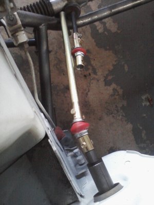

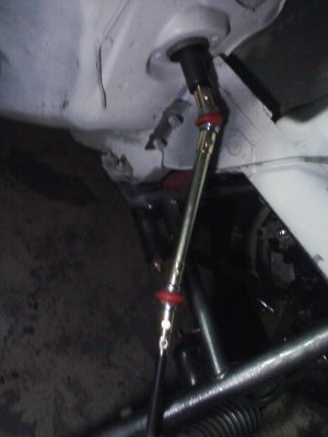

Then I started to mock up the lightweight steering linkage. It was way lighter then the stock one but I did have to cut one section to length.
Transferred the hole after cutting it to length. I was real careful to get the hole a little smaller I'd rather have it a little tight then too sloppy.
Here the Linkage is all hooked up I didn't tighten it completely I'm going to have to pull it off again once i finish the second tube for the steering column.

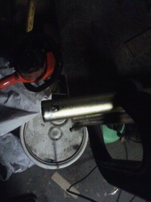

I still have to cut the 1/2 tube to length And possibly get a washer to weld onto the tube. I don't want the weld rubbing on the vinyl bushing and if I push part of the strange quick disconnect hub into the vinyl bushing it sticks. I don't really want the only thing holding the steering wheel up is the linkage. I might have to send an email over to racecraft and see what they usually do with this setup.
Hoping I can finish it up tomorrow or be close anyways.
Well I decided to run with the idea of welding a small washer onto the tube. I got it fairly snug so there isn't any play in the steering wheel forward and back. It's finished besides tearing it all apart for paint. I probably didnt even need it on there it was really snug with just the steering linkage. But I feel better with it on.
