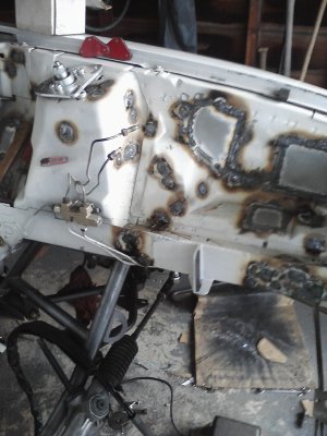

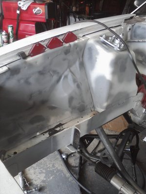

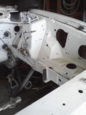

Passenger side is about finished besides smoothing and deciding what i want to do with the frame rails. Firewall is about halfway done. I Have the driver side holes to fill and a few holes that are in the fender wells.
Little comparison shot from the passenger to the drivers side.

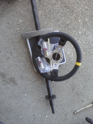

Grant steering wheel came today :D Also on its way is my Kirkey pro drag seat. My light weight steering column and shaft from race craft along with a strange quick release steering wheel hub. Should be able to actually sit in the car soon.

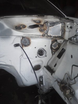

Did some more work on the fire wall today!

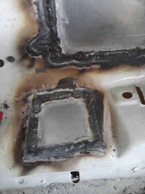

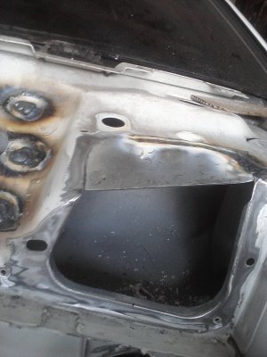

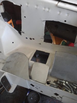

Here I started the panel for the access hole for the wiper motor. I Didn't take any pictures of the cardboard templates I made first. I think I hate making the patch panels the worst out of this whole process.
After Welding it 3/4 of the way I bent it with a small hammer just working it slowly so it made a gradual bend.

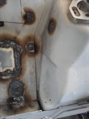

All the holes welded up but not ground yet.

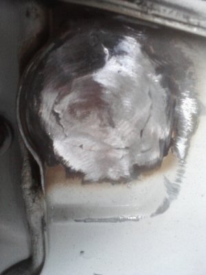

Here is a spot I think I did really well on won't even take much filler to smooth this out. There used to be 4 holes here 1 big one and 3 small ones around it. I have small 1/8 holes down barely even have to grind them after.
Here everything is ground down and primed I'll end up redoing it all later I just can't stand leaving bare metal showing.

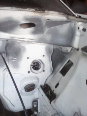

3 holes left in the firewall then on to the drivers side fender. I'm cutting out all the big jaged round holes into squares/rectangles should go much smoother!

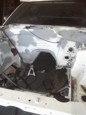

Ok Firewall is finished. :D The black plastic cowl covers the other holes so I'm not really worried about them. I'm trying to be weight conscious or I could just be being lazy cause this isn't much fun =p the welding part I dig the grinding and making patches sucks. Grinding probably wouldn't be half bad except for my little 25gal air compressor.
I also weighed my new steering column compared to the stock one. looks like I cut out about 15 lbs hard to tell with such light weight though my cheapo scale didn't measure it that accurately ;)
