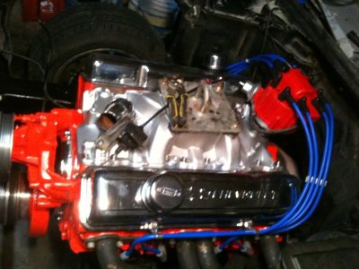

got a set of shorty plugs in her, corrected cap, and 8mm wire set (i forgot how much of a pain in the ass assemble them your self wires are)
The wire's aren't really hard at all,more time consuming than anything....But as you can see by your pic's, the results are worth it.....looks good

Hey, Thankyou!
From a technical aspect yeah they are simple, but because of how the boots were made (just a little too small) feeding the wires thru and pulling them back into the boot after crimping the connector on was a massive PITA!

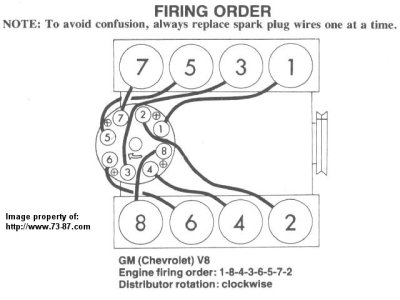

Check the dizzy and make sure its not off a tooth or two, I went back in this thread and seen this pic and it dont look like you have the plug wires right (firing order) may want to double check them also, Just trying to help
wires look way wrong forsure. but he says it wont even turn over....id be checking grounds and batter voltage too get the motor spinning. but id fix the wires forsure before anything. that thing will be popen and back firing forsure....
I think he has the corrected cap so he can route the wires nicely.

Yes, its a corrected cap and it only really turns over with the plugs out...\
