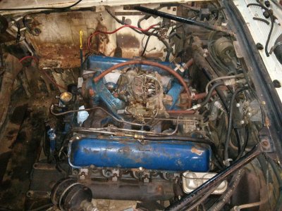

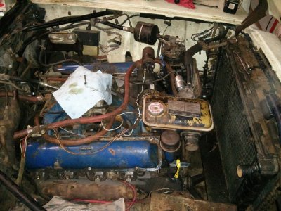

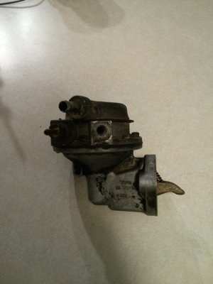

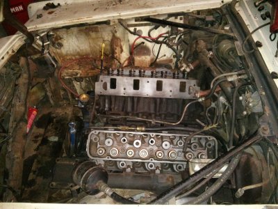

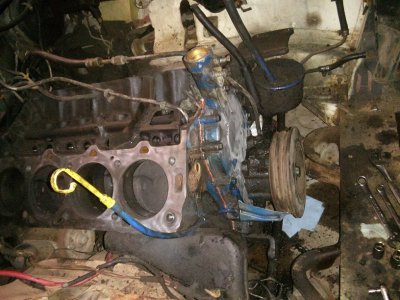

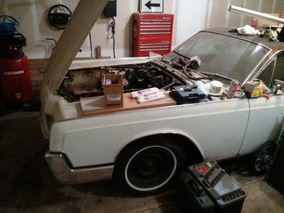

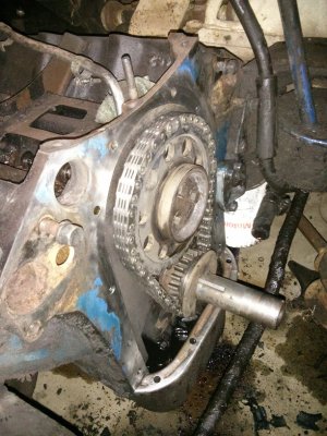

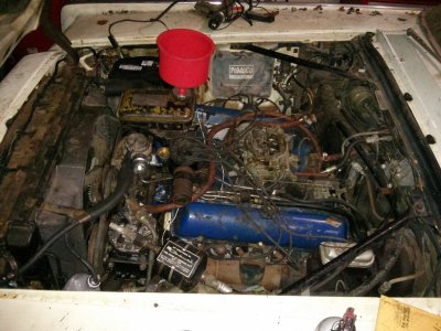

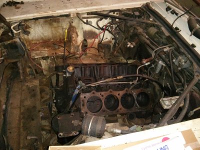

Well, I didn't want to update this thread until the car was actually running. I had a nice break from work over the holidays and spent a ton of time in the garage. Long story short, the engine is completely back together! I tried to fire it, and quickly found out my mechanical fuel pump is shot (thinking the rubber diaphragm is dry-rotted out). I'm sending the pump out for rebuild today, so hopefully I'll be able to fire it up next weekend.
Here are a few pics of the progress:

I'm sending it out to Mike Casella at Then and Now Auto in MA. http://www.maritimedragracing.com/then_and_now_automotive.htm

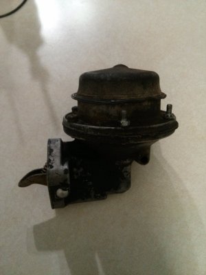

Apparently he's THE man for old school mechanical fuel pumps. $95 and it'll be better than new, allegedly. I want to retain the factory 3-port pump to avoid vapor lock, otherwise I could grab a cheapy 2-port from O'reilly's and see if it'll fire. Hoping this does the trick, but we'll see.

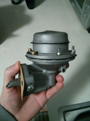

Got the fuel pump back last night.....and despite being sick, still jumped in the garage to bolt it up. Good news? The pump looks AWESOME and it's definitely functioning!
Old pump:
Rebuilt pump:
The bad news, the car's still not firing. Gonna tear into it a bit tomorrow. I'm thinking the distributor is off a couple of teeth, but we'll see.
