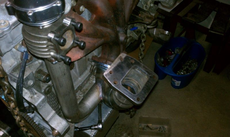

Oilpan is complete. 8qt rear sump. Very compact oil pickup. Slosh control. Turbo drain. Oldschool Volkswagon dipstick. :) Front section is 1.5" tall. As shallow as the main girdle allows.
attachment.php
attachment.php

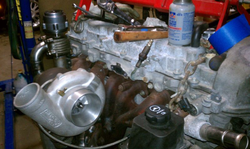

Yes it is a 100% stock 2006 Trailblazer engine. I will only be able to push about 3-5psi of boost on the stock injectors but I just want it running before changing anything from stock. It barely fits under the stock hood but I did it. Stock k member also which makes it not very easy.
Love this project. You could really make this thing scream in the future just by beefing up the right parts and turning it up. Also, that doesn't look like a PT1000 to me, looks way bigger, almost like the old pt1800.
