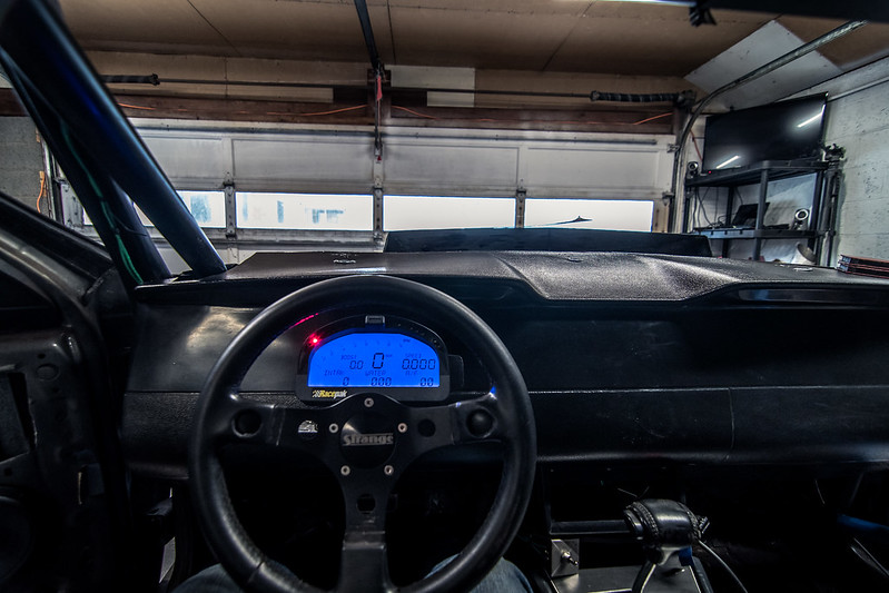

Why a radio? Because street car! Hopefully, I can find a cheap radio with USB because in these parts, the only radio stations are country and christian radio.
The dash and radio are just sitting in there since, I still have a bit of wiring to do and clean up before putting the dash in for good.
BCN_7607 by Jason, on Flickr
Also, don't we all dream about having RvW money to fund the our slow car lives?
BCN_7612 by Jason, on Flickr
Wired the radio in tonight and was able to get some Random Soul to play through the speakers. This weekend I'll clean up the wiring for the radio, tackle the turn signal and high/low beam switch to round out the wiring of the car. Then, the dash can go in for hopefully the last time.

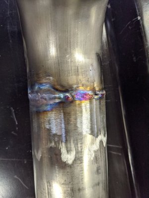

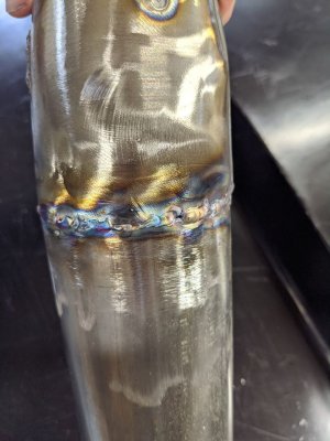

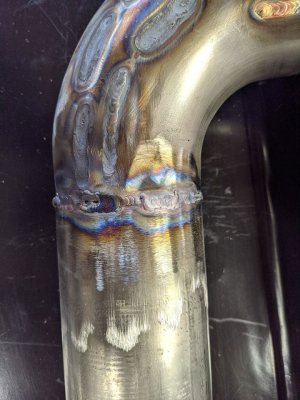

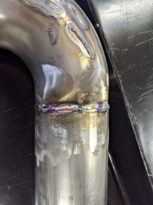

This isn't much of an update as it more filler. I got a TIG not too long ago and all of my welds on stainless looked too hot. I noticed the holes in the collet were smaller than the ones in another collet so, I drilled them out. Things started to look better. A friend dropped off a gas lens and with no other changes, things were massively better. Though, I still want to get to a colorless weld and get the stacking thing down, I can see progress. Also, the stainless I am using is thoroughly cooked.
First time welding stainless tubing, tried a few ways of working the torch. Still far away from being good but, there may be some hope.
