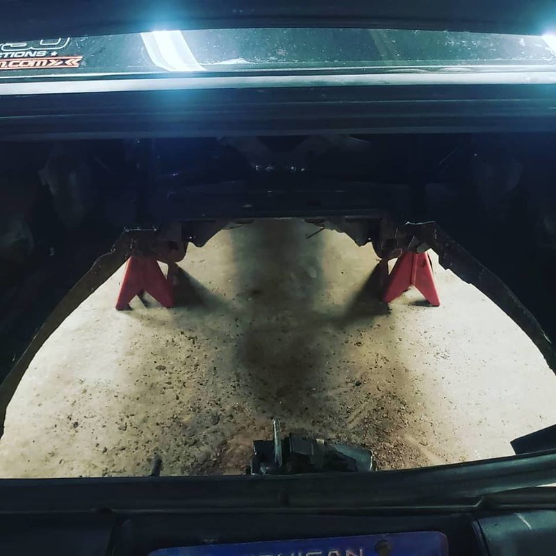

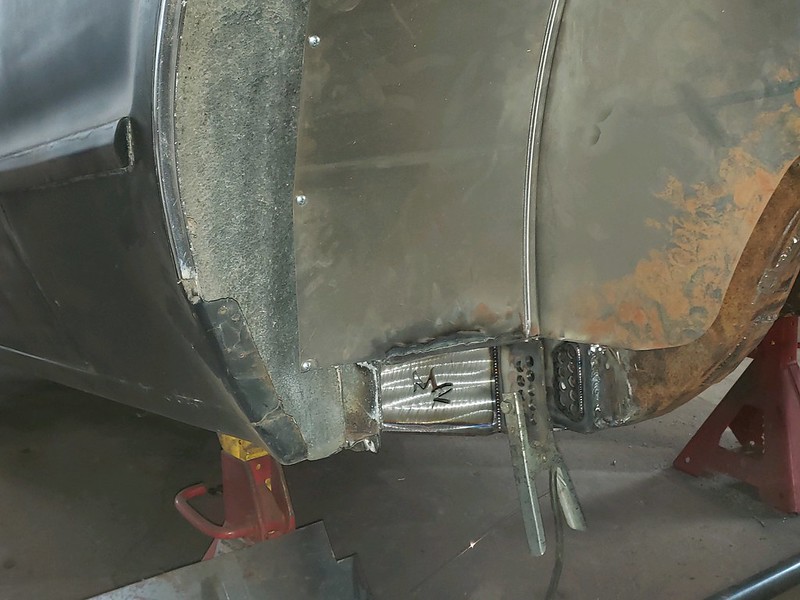

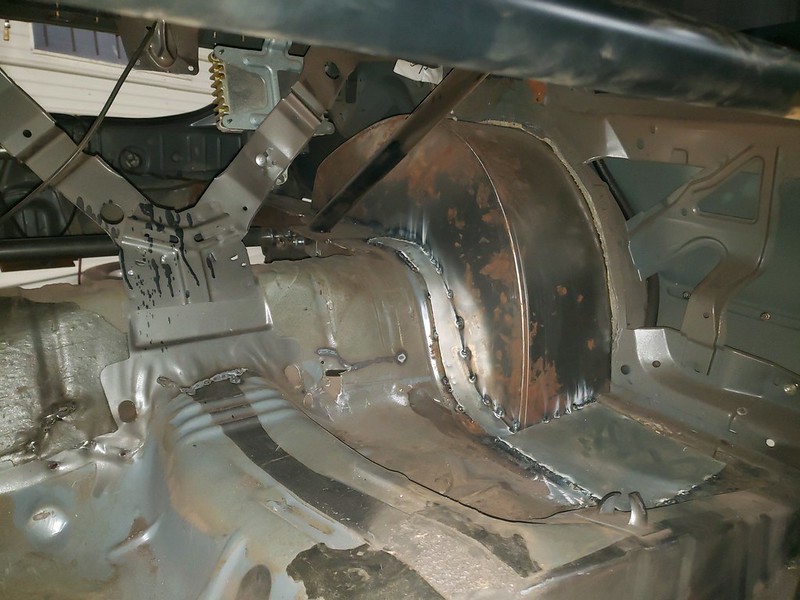

Out of curiosity, I toss a 325 under the car, to see how much room there is in the wheel well. Now, I think the car needs a 325 on it...all of the time. Now, I just need to figure out if a stock Fox Mustang width rear end will allow for that or not and, what backspacing would they require.
I have also been knocking off any of the old, loose undercoating and scale from the underside of the car then, coating those sections in POR15 and chassis paint.

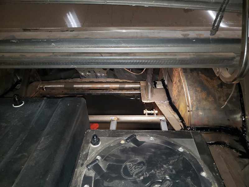

So, I started on sending power through all of the wires. I got the majority of the lights figured out. The rear harness still needs some time to sort out reverse and other lights. Once that is done, I can figure out the final routing and make all the connections permanent. I may also go ahead and wire in the fuel pumps and the intercooler pump while I am back there.
Wouldn't you know it, I go to run and mount the harness going to the rear of the car and I run out of loom...Bah, gotta order more so I can finish up the electrical that I can do. Not to mention, loom the rest of the interior harness.
I may also want to make a bracket to brace the bottom of the fuse block to the firewall, in hopes of cutting down the vibrations.

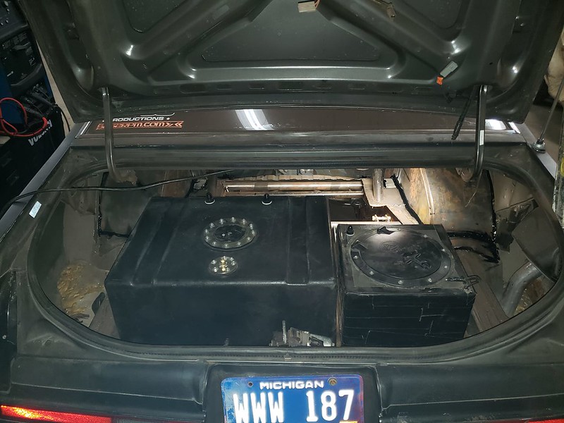

I have had the relays for the fuel and intercooler pumps for about a week now and finally got around to installing them. I still need to get a pump so, that isnt completely done but...what can you do with out having the pump? To make sure its all there, I hooked the batter charger back up to power the car then, hit the switches.
The intercooler pump squirts!
