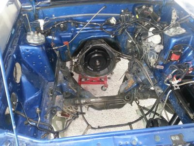

Empty Engine bay

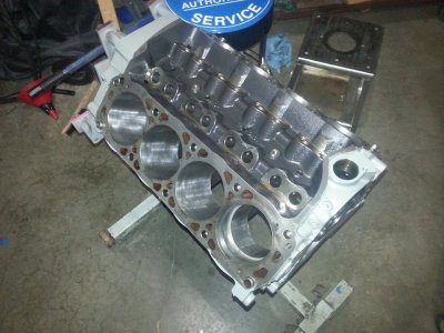

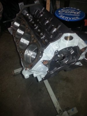

New block getting rings fitted

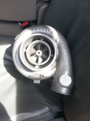

New turbo

Empty Engine bay
New turbo
