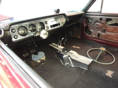

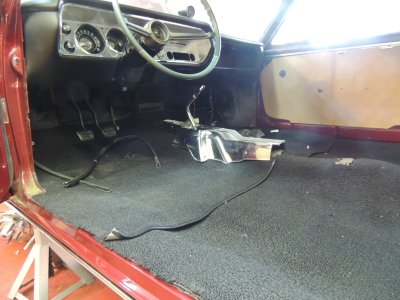

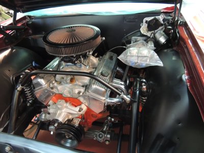

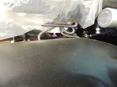

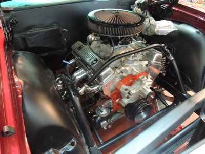

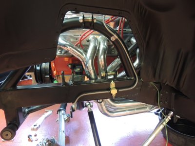

Doesn’t look like much, but I’ve gotten a lot done in the last week. The engine, headers, steering, clutch and shifter are in permanently…I put a bench seat shifter handle to move it back a little. The factory console one was too far forward for me.

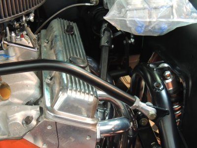

The headers fit perfectly and look great.

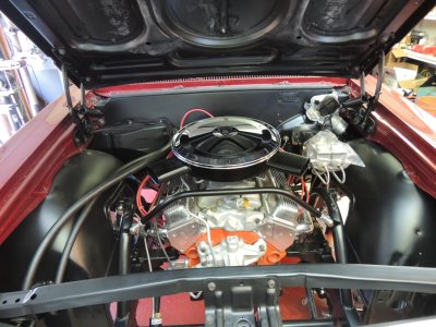

Going to change the air cleaner, but not sure what style to use. Probably going with a stock Z/28 style…Going to pick some wheels next…

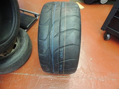

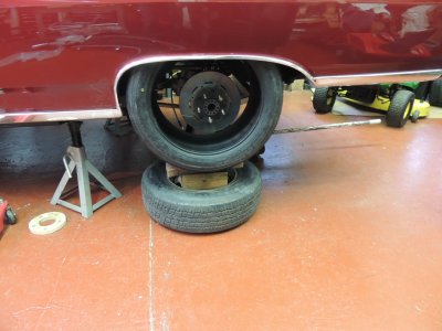

[FONT=&quot]My rear tires came today...The fronts should come tomorrow...Wheels won't be here for another couple of weeks...[/FONT]
[FONT=&quot][FONT=&quot]

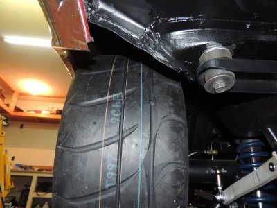

I have about 1-1/4" total clearance in the rear, or about 5/8 per side. I hope that is enough....

Working on the car for the past couple weeks. Finished brake lines, moved shifter handle back to center of console, mounted rear bumper and working on front bumper.

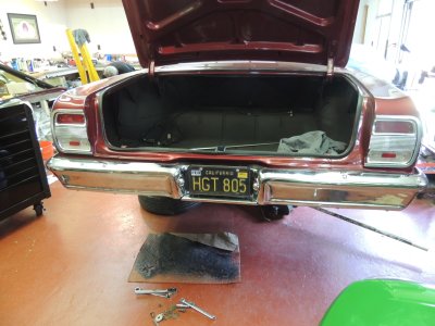

Anyway, fast forward (?) a year and I am ready to mount the bumpers to the car...The rear bumper fits pretty good even after I had to cut the entire rear clip completely off and remount it because the body didn't fit onto the chassis.

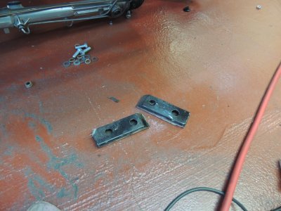

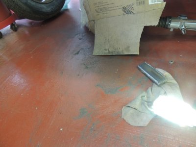

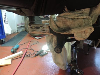

Now I try to mount the front bumper onto the chassis and can't believe it. Doesn't even come close to fitting. The brackets are at least 8" too short, about 1/2" too wide and about 1-1/2" too low. Not one bolt will even line up with the nuts they have welded in the tubing. Rather than flush mount nuts on the inside of the bumper bracket, they drilled a 1" hole and welded around a hex nut. I tried grinding the weld and nut flush with the mount so the bumper bracket would sit flat on the entire mount, but when the weld was nearly flat, the nut fell from the tubing mount.
Since the bumper brackets fit so badly anyway, I just ended up cutting the entire mount from my powdercoated chassis. I am going to make new bumper mounts, weld them to the frame so I can use the factory bumper brackets.
Some pictures of the weeks progress below....There is quite a bit of grinding dust just from cutting the mount from the frame...The mounts are also lying on the floor....

There is no way that chassis could've been made for your car. The measurements for the front bumper are not even in the ballpark. 8" too short?!?!? Geez
