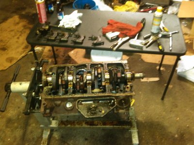

I am having the new block degreased, and honed.
New bearings + cam bearings. Money tree is shook...
next year this will breath some life

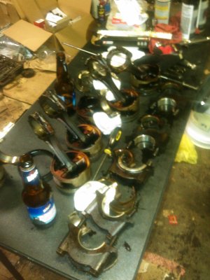

I'll upload some photo's tomorrow. Cheap kings bearings for the mains/rods, I had the mains torqued and went to torque the rods with my new wrench. Broke a rod bolt .... going to get it repaired tomorrow. If it works, I'll slap it together and she what she does at Tooslo's dyno later this month. If all else fails, I'm thinking 4.8 turbo or somebody else's 302w.
These are from earlier this month. Got the kings rod/mains bearings in. F303, comp timing chain are in. Picking up an oil pump, pickup, pan gasket from summit.

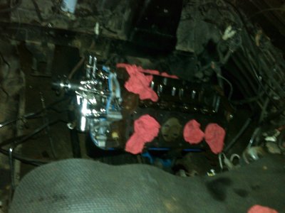

302 should be in the engine bay tomorrow.... probably gonna jack it up throw the t5/driveshaft in. Then i will install the heads and intake... hopefully I can finish up mid week and hear it run :D.
Then 4.10gears and rebuilt diff :D.
Ill upload the rest of my photo's tonight. Timing is set at 22* or 23*, car idle's and revs amazing now.
Needs radiator/hoses, power steering rack bolted back on, fluids - oil and dipstick.
