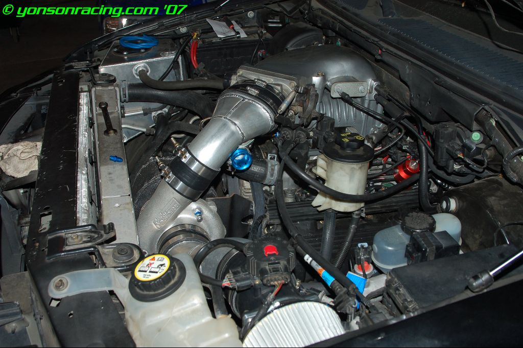

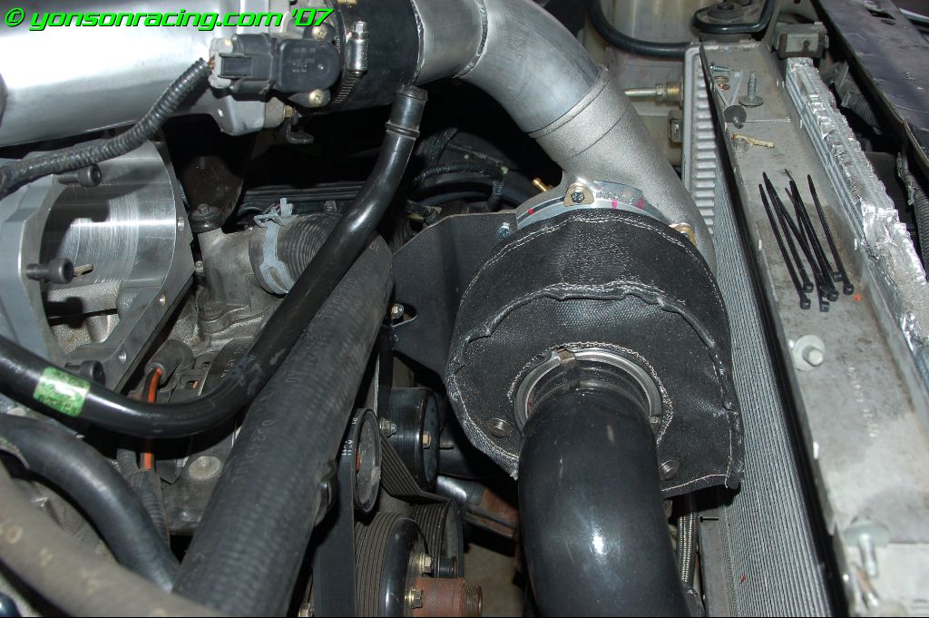

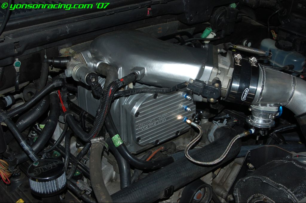

I normally don't give a rats ass about dyno #'s, it's what it does at the track that counts, but on 12#'s of boost and 14 degrees of timing with 93 octane fuel it made 420 HP 450 TQ on our Mustang dyno...
I dunno if that would work. Those Eatons take alot of power to turn, plus they add heat. I didnt check the link, but am I not seeing an intercooler on there? I know ZZP makes an air-water intercooler for the M90 that mounts inside the blower housing. Wonder if anybody makes anything like that for an M112?
For now I'm just using the stock air/water intercooler that is mounted under the blower. It seems to be working ok, but I'm prolly gonna need to upgrade the heat exchanger, after 6 full pulls in less than 30 minutes my IAT2 reached a max of 169, but that was with a LOT of boost on that pull too...
No, I figured leaving the stock opening in the bottom of it might help with spool time. If I decide to make this an all out race project I might do something like that in the future, but for now I think it will be fine.
