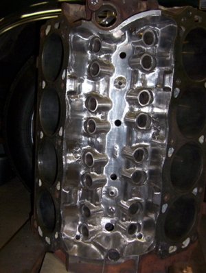

Now that I have finished the work on the lifter valley, timing gear area and the main webbing the block has been dropped off at Reichert's for a plane jane 30 over bore to fit the above mentioned brick heavy speed pros. Once that comes back and I can do an initial mock up it'll be going back for a decking dependent upon how far down in the hole these things sit and ptv clearance.

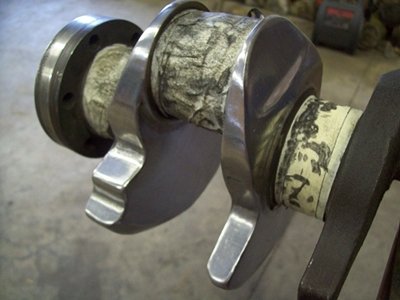

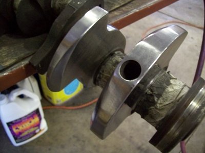

I started polishing up the stock crank over the weekend and got 3 of the throws done. I had started working over a set of stock rods, but since I'm still going to be swinging 570 gram slugs I've put that aside to run un-worked stock rods for this year.

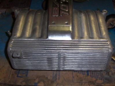

, Due to financial restraints it's now a serious budget build using all stock internals with as many low dollar tweaks as I can think of. My hopes are with the increase in compression, increase in flow from the good valves and the comp. valve job along with getting windage, and oil control in check I can get this pig solidly into the mid 11's and occasionally dip it even lower while using stock parts, and no power adder. My one concern is the matter of going from my current Typhoon upper/lower down to an explorer intake. I'm really not sure how much (if any) I'll be giving up there. I guess time will tell after it's together and sorted out. Should be fun!
