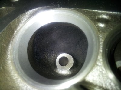

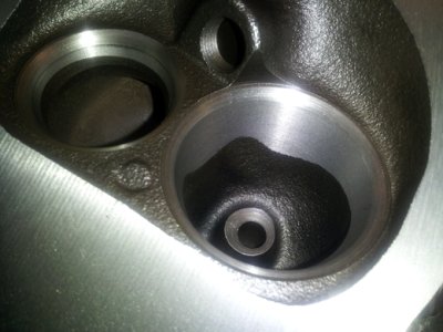

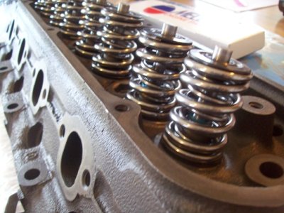

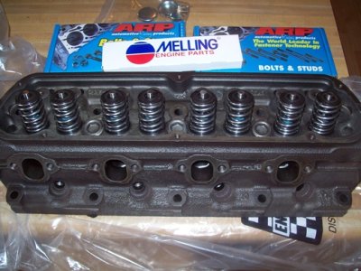

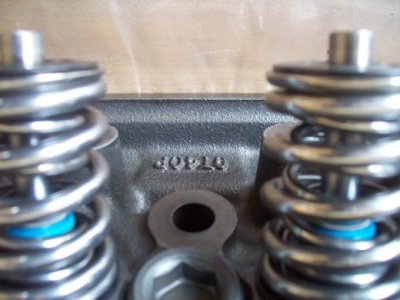

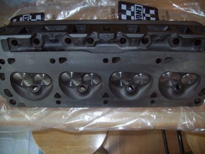

The GT40P heads are now with Scott Brown having the new valves installed, getting milled down as far as safely possible, and getting a competition valve job to be followed up by a nice light-weight package valve spring kit to get rid of my valve float through the traps at 6500.

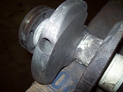

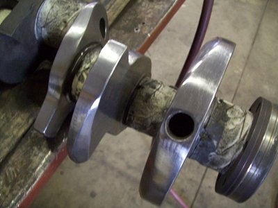

I started polishing up the stock crank over the weekend and got 3 of the throws done. I had started working over a set of stock rods, but since I'm still going to be swinging 570 gram slugs I've put that aside to run un-worked stock rods for this year.

nice! what method are you using to polish the crank throws? Would this require the balance on the crank to be checked?

I have alot of grinding/polishing stones for my grinder, and even more patience, which is a good thing since I lack funding, lol. The entire bottom end is going to have to be balanced regardless, however I am not removing excess weight (at least not a bunch) since I am still going to be running stock rods and heavy stock type pistons. If I were to remove too much than there would be issues with the bobweights when it's time for the balance. So my goal is to not vastly disrupt that but more to just polish it up to keep the oil from latching onto it.

Here is a shot after the initial phase;

Those blocks need all the metal they can get I thought?? Or is this like polishing rods to make them stronger?? :)

Well since this is going to be a P-headed NA application that will not even be remotely approaching the danger zone I'm not concerned with the block. I would like to go with a .060 piston but the walls just won't support it while maintaining a good ring seal. So I guess that'll be when I can afford an aftermarket one.....yeah, right!

These would have been shot peened after the polish and work to relieve stress, not just simply polished. I think most consider smoothing casting flashes and sharp corners to relieve the stress points their polishing and call it done without shot peening them and now they are magically stronger.
Actually, FWIW, shot peening actually introduces compressive stresses into the material in addition to reducing stress risers. It prestresses the surface and work hardens the material while removing tensile stresses that occur from grinding (or polishing) and heat treating. So it kinda swaps bad stresses for good pre-stressing. Smoothing the casting flashes and sharp corners addresses locations with stress risers, peening is the next level in reducing stress risers. Peening improves fatigue life and does increase ultimate strength limits, but it's good to note that the UTS is often diue to removing the stress risers, so I think many overstate increase in mechanical properties from peening. The bigger benefit is the dramatic increase in fatigue life after shot peening. I say all this because I think it might be even more worthwhile to polish and peen your rods when running the heavier pistons. Higher tensile stresses from the heavier pistons, higher fatigue loads.

Wow, that's what I've read, just in less words LOL. Yea, I've seen the major differences in fatigue life first hand. I do dynamic fatigue testing of steering gear components. We had a certain gear that the teeth kept breaking on under typical production methods. The proposed answer was to shot peen the teeth. In untreated gears we would see breakage prior to minimum requirements outlined. With shot peened teeth I was running them out 8.5 times that and still not fracturing them. Good stuff! I would either send them to Reichert's in Owosso or hand them off to Scott Brown of Competition Components in Okemos since he is working with me on this budget build. I never did think of it in that way, in terms of actually using them with the heavy pistons, hmmmmm. Thanks!
Well yesterday was a day of good news, and bad news. The good news was that I got word from Scott that the heads checked out good and they have installed the new valves and completed the competition valve job. They did require guide inserts on the exhaust side though. Now he is going to cc them to figure out what is needed to cut them down to be where we would like on them.

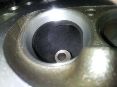

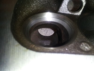

I got my 1st peek at the heads since I dropped them off back in January. They have since been cc'd originally at a whopping 63cc's, and cut down to 54cc's. Guide inserts on the exhaust side, guides turned down for the smaller spring package, and they've also been treated to some nice aftermarket stock sized valves and have been given his race valve job. They will also have received a nice lightweight spring package that can handle the rigors of the expected r's through the traps, unlike the current springs at less (anticipated) mph.
