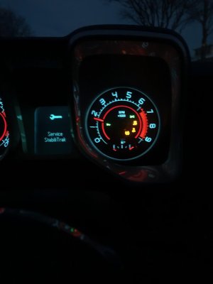

I drive the 2011 Camaro and when the service stabilitrak comes on, It happens intermittentlywith mild-hard acceleration and the entire car starts to shake, the car downshifts and goes into what feels like a reduced power mode, there is a rattling noise coming from the rear end and the car overall drives very rough. If I don’t immediately turn the car off, the problem will correct itself after some time and the car starts to drive normally again however all of the check lights are still on. In total, the car has been in service for 20 days for this problem and It still isn’t corrected.

So I drove the car a bit today and got all the lights to come on. The only code in the DTC was P0207. "Injector Circuit Malfunction - Cylinder 7" so this is completely screwy. One thing the dealer did last month was all new injectors but I'd be at a loss to see how this is related to everything else. The check engine light was on too in addition to everything else.
A misfire will shut the stabilitrak down so that is probably why they did the tune up, injectors and stuff
