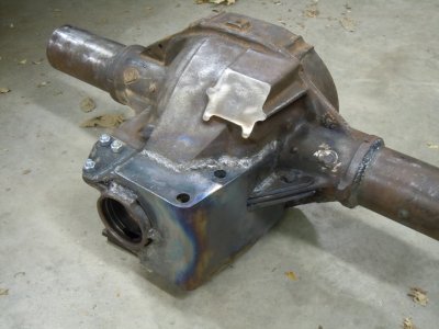

I was going to go this route when I had my trans am. I was told and had saw to many issues with the TA mount breaking on the 8.8. The issue isn't making a 8.8 hold power it's getting that mount to stay on.
I have put literally 2000hp to an 8.8 before it finally bent up, but when it did, it was in an area that a stock 9" housing would have anyhow. They can be built to be very tough.
This is the mount I would be using, the "hiltsy" mount:
So far people seem to be having good luck with them. Some have proposed bolt-on solutions however no one offers them for sale and for my goals I don't think I need anything fancy.
