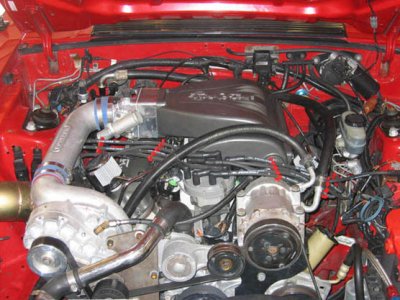

TwilightBlu92 said:
How do you keep yours in? With the extra boost, it just keeps coming off and spewing oil.
TwilightBlu92 said:
Nope, no black smoke, My oil plug at the rear of the lower intake did keep poppin off though. I have to find a way to fix that.
Did you plug that tube coming from the TB and put a breather in the valve cover?
