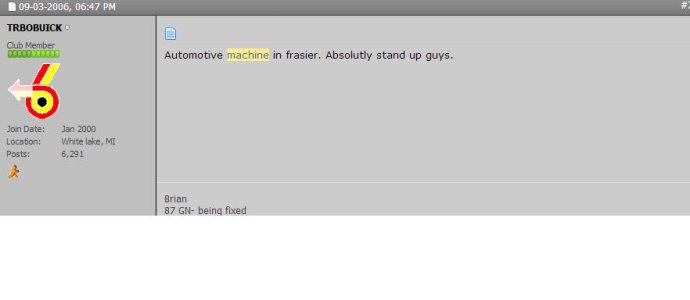

Is this thread about the engine they built for you? http://motownmuscle.com/forums/showthread.php?33657-New-best&highlight=engine
posted about the time you say you had your work done and posted this?
seems you were happy back then. maybe you happen to hurt it in the last 10 years and want to point the finger. Rod bearing falling out of big ends is a big clue something in the tune was wrong id say.
