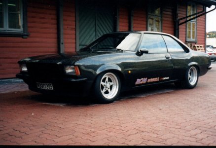

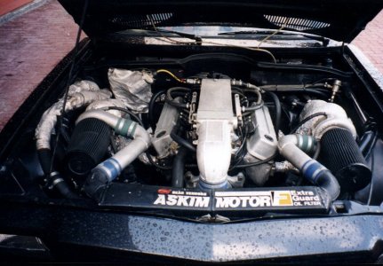

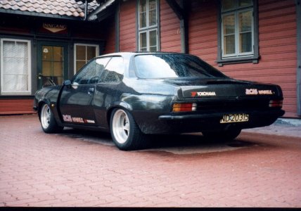

He has modified a 72 Opel Rekord and fitted a chevy V8 with BiTurbo and intercooler in it.
A 302 chevy with Garret T04 turbos, Zytek Formula 1 engine management system, Carillo rods, Wiseco pistons, Brodix Heads, Jesel Gear drive and rockers, Competetion cam etc. This engine dynoed 880 hp at 5000 rpm. The teoretical top speed was roumered to be over 300km/h

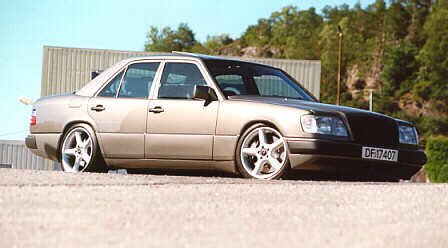

The he took a Mercedes E-class(W-124) and put in the engine and driveline from a Corvette ZR-1.
Is said to have had 410 hp and topspeed of ca 300 km/k
