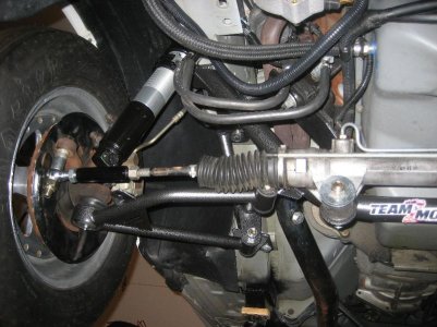

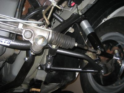

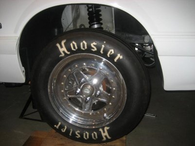

Here are some updated photos of my complete Team Z & Strange tubular/coilover front suspension.

How many threads does the Driver Side Inner tie rod have in the Bump steer kit???
That is a concern of mine. Do you have any advice? I don't have the toe set right yet, but it is close and I am getting concerned about the number of threads............
Only way U can fix that is to machine a longer HEX piece for the driver side....It was also a concern of mine when I bought one...
Maximum Motorsports bump steer kit has a hex sleeve that is about 1" longer than what I am using.....I may have to buy their kit.
