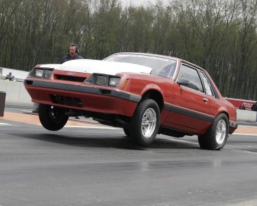

Here is a 275/60/15 Drag radial at work.
Leaving around 4600 RPMs, proshifted T5, 18 pounds in the tires. 15X10 American Racing Trakstar wheels. Car weighed 3150 with me in it. Nothing fancy here promise.
These 2 guys above (NVR2FST & Paul Wiley) should be able to help you they helped me out a lot. Now just think if I would have actually taken the time to test and didn't use qualifying passes as test passes.
That picture just sold me on a 10" wheel.
When I bought them I figured I'll only run a Drag Radial for a short time and then switch to slicks so I wanted the wider rim. That was the thought behind my decision. Everyone else said get an 8" or at max a 9", but I know a few others that ran a 10" wheel with a 275/50/15 and it worked really well, it is actually has a wider foot print than the 275/60/15.

this car is ona 275/60 and is on a 10 inch wheel. sbc/nitrous combo.
Wow, thanks for posting. Makes me feel comfortable running a 10 inch wheel.
