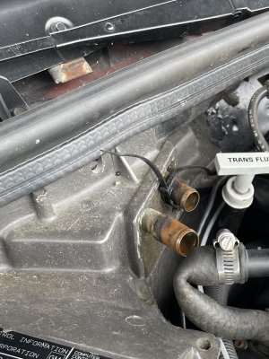

On Wednesday my rear sway bar finally showed up and I took it to the shop to have that installed. No problem. I left work early for a Dr. appointment. I'm cruising down 275 and I look down and my temp going between 210-220 and all I smell is coolant. Thats because I have a gallon of it in the passenger side floorboard. Heater core blew. I get off the highway and make my way to an Orileys. I was able to buy the necessary parts and tools to bypass the heater core and get back on the road and get to my Dr. appointment on time.

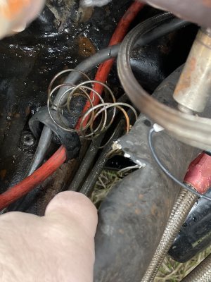

I am on the way home and get on to M5 and I get on the boost a little. Didn't hammer it. I look in the rear view mirror and see a huge cloud of white smoke. All the gauges were OK so I kept driving. All the way home to Southfield. I pulled into a restaurant across the street from my house to pick up lunch and I see it smoking from under the hood. I pop it and see my lower radiator hose had exploded. I drove it from 11 mile and Halsted to 10 mile and Telegraph with no coolant in the car.

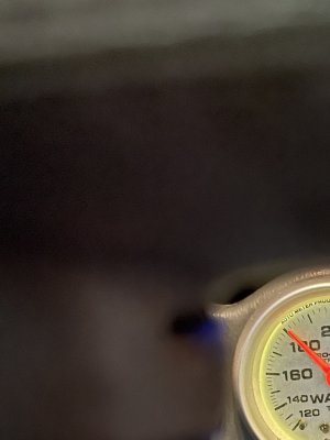

I went to Bowling Green and brought the car. After the repair, the car was running good, but hot. With E-85 it runs about 170 degrees and it was staying around 205-210. We pulled the plugs and found # 6 was wet.
