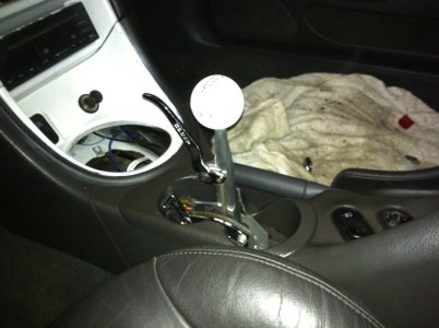

Mounted my shifter where the cup holder used to be, now I need to fab up something to block the old opening. I really like the location though, feels alot more natural. Shitty thing is that it now seems as if my starter has gone out...fml
