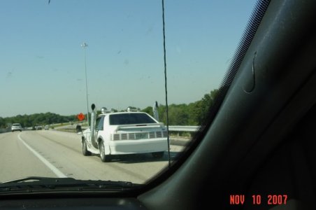

How are you gonna exit the exhaust? I think this would look cool...........
