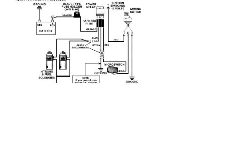

Got a quick question already. What wire do i tap into for a rpm signal for my window switch? i have a ford schematics book and i dont see any tach wires, i see ignition coil wires, what should i tap into? also, where did you guys mount your relays,window switch? thanks!
Look at this picture, i just need to know where i will be wiring in my window switch and fuel pressure safty? will it be to the BLUE wire that goes to the solenoids?
thanks!
thanks!
you'll want to put them before the relay, not after. as for where to pick up the rpm signal, you'll need a tach driver for that, iirc. summit/jegs sells them.
kovacs32 said:
so where at before the relay would i wire them? to the micro switch ground?
i think the window switch has pretty specific instructions on where it goes. i've never installed one though. i think larry knows more.
