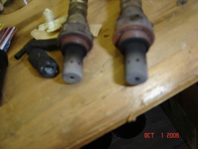

kovacs32 said:these are my old o2 sensors that i replaced when i put the new motor in. If im not mistaken the white means a lean condition? BTW its from a 99 mustang Gt
thanks,
ryan
Sean said:Hmm lots of cam overlap ( raw fuel in exhuast ) or alot of missifiring like ignition issues with cheap heavily additived gasoline.
