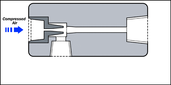

they use a venturi to pull the water out of the sump. basically the city water creates a vacuum when it rushes past the suction tube at a high velocity.
picture this with water instead of air:
they arent talking about battery backups, but rather city water powered pumps. city water never goes out (or shouldnt at least) so you dont even have to be home for these pumps to work. you do have to be home if the power goes out to hookup the generator.
