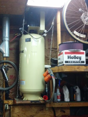

Insulate it the same as you would your house. After insulating, I sheeted my walls with pegboard instead of drywall. I can hang stuff anywhere, and all over the inside of the garage. Floor space is your #1 concern. Everything that goes in the garage needs a home up and off the floor. I looped the entire garage with shelving that is high enough that I can work underneath it. Make good use of your attic space. If you wont need an item for 6months or better, then that's a great place to put it. I have an 80 gallon upright compressor that I have hanging from the rafters. Pulled it up with a good block and tackle.

Do you have a pic of your compressor setup?

No, not at all. I think the chains absorb a lot of the vibration. It's somewhat quieter as the head unit is partially above the ceiling. It's up as high as I can get it, as it's the soffit side of the roof. I can pull my F250 in the garage,(it just fits front to back) and the hood fits right under it.
