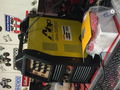

Well I could either go with the offshore brand or maybe not be able to afford the US brand in my life time. I went with the AlphaTIG.
$799
This is the 2018 model, so it has a lot of changes from the original. It seems to be really nice.
If you ordered thru there distributor, you might be able to net some cost back since there site sells direct for less. The AlphaTIG 201XD is 750.00 shipped direct.
I got a good deal. I just added 4 years of warranty to it.
Seeing how the manufacturer automatically covers the unit for three years from date of purchased with the exception of the secondary components, which are covered for six months from date of purchased, adding any additional coverage seemed unnecessary. After reading various reviews, the trend in failure typically are immediately identified & determined defective. I don't foresee the AHP unit being a huge hot pile of poop. lol
I just figured I would be safe. I read and watched some of the reviews and there were some concerns on the torch, pedal and hoses. This one being the 2018 version seems to have corrected a lot of those concerns. The parts appear to be more robust than what I saw on YouTube. I’m happy with it.
