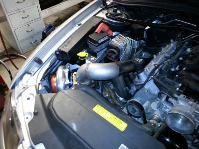

This project is in its infancy stages right now. It is a Ls1 with a 6 speed. I am collecting the parts, and have almost everything I need. This will be a home garage build with a very small budget. This is the wife's car so the build will be mild with around 450 rwhp in mind. I am using an ON3 76mm turbo which I have used on other turbo projects and works flawlessly. This will be a front mount turbo setup and this car is a very tight fit for a turbo. I am keeping A/C so that will be hard to work around. If you guys have any experience on doing a turbo GTO or have sugestions, lets here or see them. Here is a pic of the car right now. I will probably start tearing it down in the next few weeks. Ill update as I go.

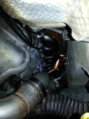

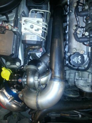

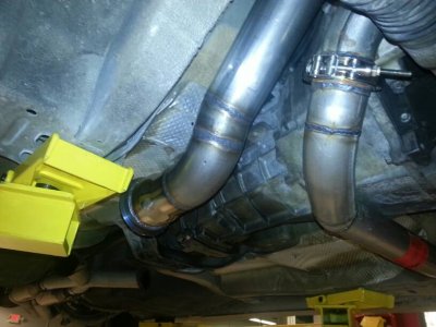

Got some pics from my phone. Wanted to do a driver's side front mount turbo but there is virtually no room for the exhaust. So I did a log style passenger header. This engine bay is tight. I know what I built is not optimal but it will work for my needs. I still need to build the down pipe, mount the wastegate, and make some mounts for the piping and turbo. That should complete the hotside.
Sent from my SCH-I535 using Tapatalk 2

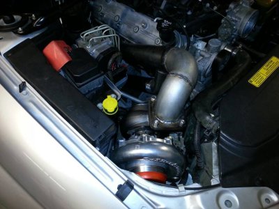

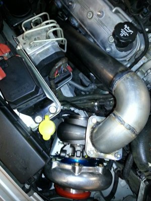

The turbo is so tightly packed in there that I'll have to use a screen. I ran out of gas on the tig welder so more work will be next weekend.

TIGHT setup!! MIGHT need some heat shield. Can't wait to see the WG/Downpipe. Don't forget the O2 bung, I forgot to add an extra on mine while building. Keep it up!
Thanks, I have the O2 bungs already, still need to put them in. I have heat shielding, exhaust wrap and a turbo blanket. It's hard to get alot done at once, I only have a few hours on the weekends to do anything.

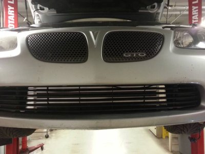

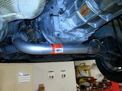

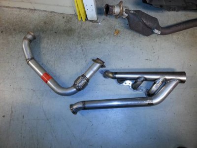

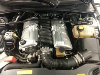

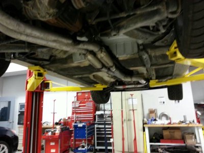

Here are some update pics.
