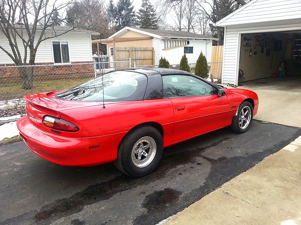

Here's a few quick crappy phone pictures.
No real updates. However I did back it out today and look at it outside for the first time with the new shoes. All done minus a tune at the moment. Just restored my headlights. Sunoco hood, SLP grille and SS spoiler and it will be complete.
