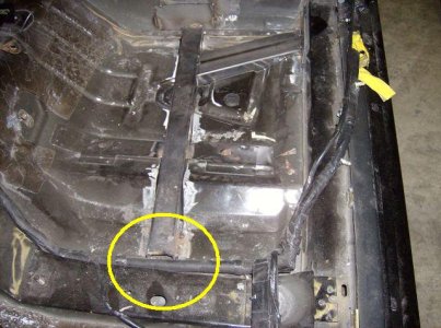

Hi, Just wondering why do these stop here, why not go all the way to the front frame rail?
The rest of the subframe starts there. We end it there. Anymore, it would just be added weight. With the whole cage tied into the front, I doubt we should have much, if at all, chassis flex.
any more and it would just add weight??????????????
Just make sure the carpet is in when you go to certify it!
I did not see anywhere in the 25.5 book that states the subframe connectors have to go all the way up front?
Care to pm me some details on how this is wrong?

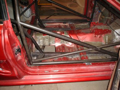

not trying to be a dick but I saw 2 cars get failed at the cert seminar because the 2A bar did not intersect with the 6A bar like it is pictured in the 25.5 book, it says the 2A bar must be 1 1/2 .065 round or 2x2 .083 and the stock sub frame is not 2x2 or have a thickness of .083
If the guy would have had his seat and carpet in it would have passed, I know the chassi cert guy in northern Ohio failed a well know DR car for not having the 2B bars which the Wolfe kit dosent have either.
Again I'm not trying to start problems for you, if your customer fails cert, you look real bad. Those bars (the 2A and 2B) are easy to add and will definatly help the way the car works and will help pass tech inspection!
sorry if I posted this in the open but guys like Raj wanted to know why I said that!
here's a pic of one that we did that certified the day the other 2 failed!
the ohio cert guy is tough, i'd hate to see you do all that work and then have to re do it!
