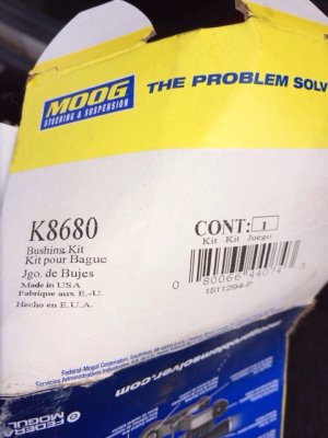

Uhhh they aren't obsolete... Moog still makes them and way cheaper then what you're paying for those....
Lol. Yeah been there done that as well as many mark viii owners before me. I've done srbs about 5 times on this car. They're fine for a couple weeks but begin to deteriorate after that. There's some things that you can get away with using the cheap aftermarket stuff. This is not one.
The moog ones are garbage...... already put two sets on within the last year.
When you guys received these parts... See if there are any numbers on the boxes/bags... I wanna check into something...
These are the ones that you ordered from American Air Suspensions?
No. The ones from aas are ford e9sz 3a140-b and 3a141. By that last post, I'll assume you meant to say receive and not received in your previous.
Moog ones need to be modified to work right and still will fail sooner then later. OEM in this application is the only way to go.
Right. And being that the car was/is being drag raced, I'm sure the launches aren't too easy on the bushings.
