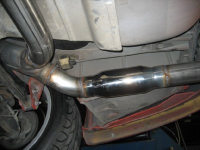

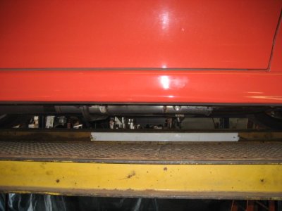

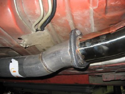

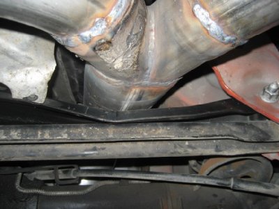

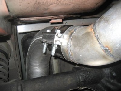

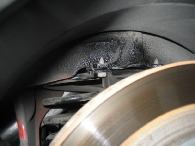

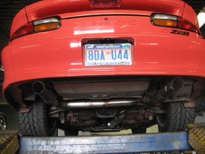

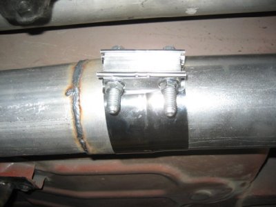

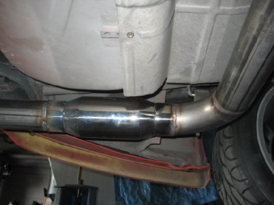

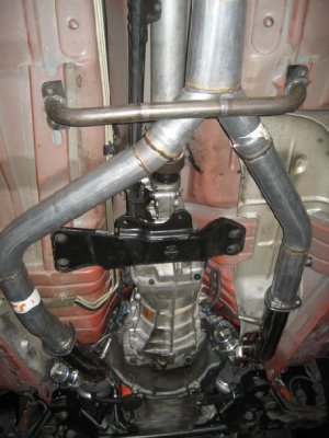

Picked up the car from PFE with the finished exhaust today. Looks and sounds sweet!!!!! They did a great job. It is a 3"Y at the front into a 4" pipe down the length of the car and over the axle. Back into 3" outlets with bullets in the tailpipes. They gave me an O2 bung for tuning and even made up a better floorpan brace in the process. They were also kind enough to trim my bumpstops as we discovered I had not done enough BFH work to them once the car was on the lift. They welded flanges on the downpipes, and clamped everything so I can disassemble sections of it to service the car. I had wanted twin outlet tips but none were available today so I have the single outlets. May switch to the twin tips later on. Overall I am VERY happy with the look and sound of the exhaust. Can't wait to hear it once I get the car tuned. More vids will definitely follow!
Next I drove it over to drop off with the tuner. We had to fix my EGR blockoff as it was leaking and messing with the idle. We got that all squared away. Phil will tune it and put it on the dyno tomorrow. Unfortunately I am driving to NY tomorrow morning so I won't get it back until Sunday and won't be there to record it on the dyno. But it will be ready and done when I return! Woohoo! Might even have to take it to Milan on Tuesday for the track rental....
I had an exhaust almost exactly like that once, although it was just with standard Dynomax bullets. Sounded great but was loud as hell! Guess the turbos will help with that. ;) What kind of mufflers are those?
No clue what brand the mufflers are. They mentioned it and I already forgot. Ha ha.
