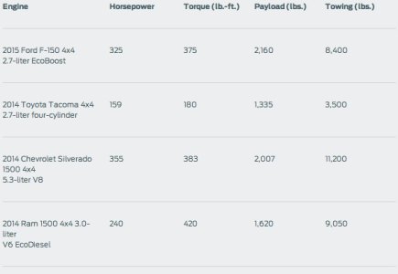

2.7-liter EcoBoost power
The high-output, twin-turbo 2.7-liter EcoBoost V6 features an entirely new design that delivers power and performance in a strong, smart package. The engine produces 325 horsepower and 375 lb.-ft. of torque – improving the power-to-weight ratio of the 2015 truck by 15 percent over the 2014 5.0-liter V8-equipped F-150 with similar torque output, thanks to vehicle light-weighting.
The 2.7-liter EcoBoost 4x2 has a maximum payload rating of 2,250 pounds and maximum tow rating of 8,500 pounds, ideal for meeting mid-range capability needs.
Boosting 2.7-liter EcoBoost fuel efficiency is the debut of standard Auto Start-Stop technology for F-150. This technology, specially tuned for truck customers, shuts off the engine when the vehicle is at a stop. When the brake is released, the engine restarts quickly. Auto Start-Stop helps reduce fuel consumption and emissions when the truck is stopped and the engine is off. The technology is off when towing or in four-wheel-drive mode.
The 2.7-liter EcoBoost engine also features Ford’s first use of a compacted graphite iron cylinder block in a gasoline engine, the same material used in Ford’s 6.7-liter Power Stroke® turbo diesel V8 in Super Duty trucks. The composite CGI/aluminum cylinder block saves weight while providing strength where it’s needed most for durability.
Advanced technology, power and efficiency combine to create an engine for F-150 that boasts more than twice the horsepower, torque and towing capability of the Toyota Tacoma midsize pickup truck with identical displacement 2.7-liter four-cylinder engine.
Ford testing shows the 2.7-liter EcoBoost also outperforming Ram 1500 3.0-liter V6 EcoDiesel and Chevrolet Silverado 1500 5.3-liter V8 while towing a 7,000-pound enclosed trailer up Davis Dam in Arizona. This is the same grade the Society of Automotive Engineers uses for its J2807 towing testing standards, which the 2015 Ford F-150 will follow.

I'd also like to see the actual dyno graphs of them versus the competition. My 2014 GMC *only* puts out 30 peak hp and 8 lb-ft of peak torque more than the 2.7L Ecoboost, but let's compare across the engine's actual operating range.

no fuel economy numbers Unless they can average 21MPG im not impressed
I'm guessing with the way Ford responded to questions about Fuel Economy it's going to suck. It'll also be interesting to see how it compares to 2015 models of their competitors. This is a Ford announcement, so I take more from what isn't listed than what is. Didn't talk Fuel and didn't talk where in the power band the power hits. I realize some of the competitors don't have their data out there, but there's enough that they could match up to 2015's to see a comparison. Ford also doesn't make any claim to be SAE J2807 for towing capacity. It appears Ford is the only one who hasn't conformed to that standard. So I take all their data on towing with a grain of salt
