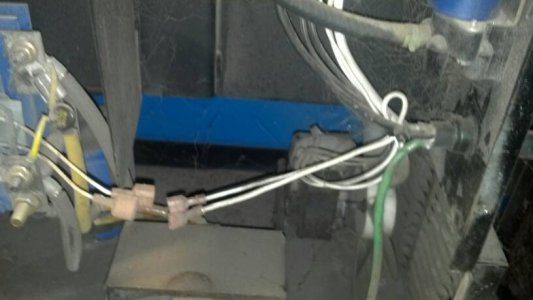

I seem to be having a hard time keeping my MIG and TIG running these days. My TIG was down after I dropped a piece of exhaust pipe perfectly on the hoses, and sliced 2 of the 3 hoses completely in half. That's fixed now, but when I went to use the MIG last week, the trigger didn't work. I checked the connection from the gun to the welder, looked good. I even hooked up the spare gun I had, and it did not work either. Power comes on, fan comes on, just no response from the trigger so the spool does not advance. It's something internal, and I have not opened up the case to look (no time). Since I am bored as hell and sitting in a meeting, I'd thought I'd ask to see if there are any common places to look while troubleshooting..
Welder is a 15+ year old Millermatic 150, 220V unit.
