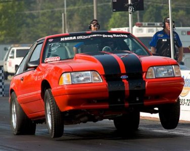

OK get ready for this...
306
stock cam
Unported GT40's
Cobra upper and lower
Shorty Headers
Full exhaust
T5
Speed Density
BFG Drag Radials
Oh and did you notice the stock front suspension?
Best pass 11.98 @ 111mph

STFU! LOL. That's a combo that's working good.
What kind of suspension? Looks like a full cage in the car.
No really.
suspension
front: stock K-member & control arms
Lakewood 90/10's & Moroso trick drag springs
rear: UPR
Lakewood 50/50's and cut stock rear springs
12 pt moly cage courtesy of Todd Reiter (Reiters Metalcraft)
nothing fancy
