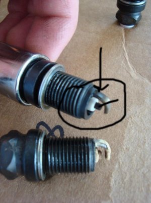

see where the arrow is pointing. Thats your timming mark. Your way overtimmed or the plug is to hot. See the bluing in the threads just beyond the timiming mark. Thats where the plug is superheating from excessive combustion tempatures near the plug. Its borderline preignition hot.
the slash across the ground strap indicate where you might generally like to see the timing mark in the ground strap.

yeah I think you need a colder plug too, I had a similar issue back in the N/A days. I had to settle on a 2 heat range colder than stock autolite copper plug in order to not detonate on straight 93 octane.
